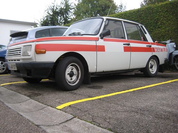

Unfortunatelly the result is not what I wanted. But it's all my bad, I should have ordered springs shorter. I'm afraid what will happen with the back, but we will see. Maybe it will take some time until the spring adjust and settle, at this moment is between 3-4 cm lower.
Here are some pictures:
I do not know if the distance from the ground to the side skirt on both sides is the same with stock suspension, but in this case the difference in the height is ~4.5 cm.

Beitrag von Haiko » Sonntag 14. August 2011, 11:39
Hmmm, doesn't look that bad at all! Nice rims you've got on the front! :mrgreen:
Are you gonna fix that fender (Left front), it looks it has rust on the typical Wartburg (1.3) places...

On the right I have the same problem, but at first just wanted to fix the suspension. This will be the next thing.
Regarding the height, I think that one C20XE will fix everything on it's place.. :D The winter is long, we will see.
